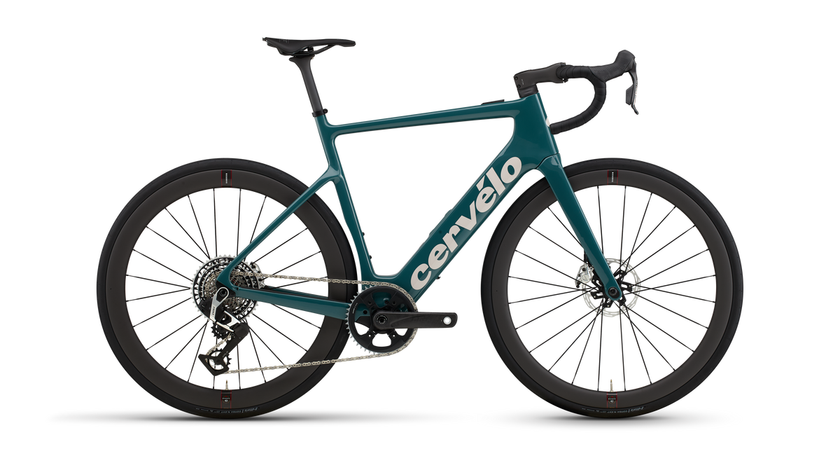

Rouvida red xplr e1
Peacock
$12,150 USD
More Miles, Less Effort

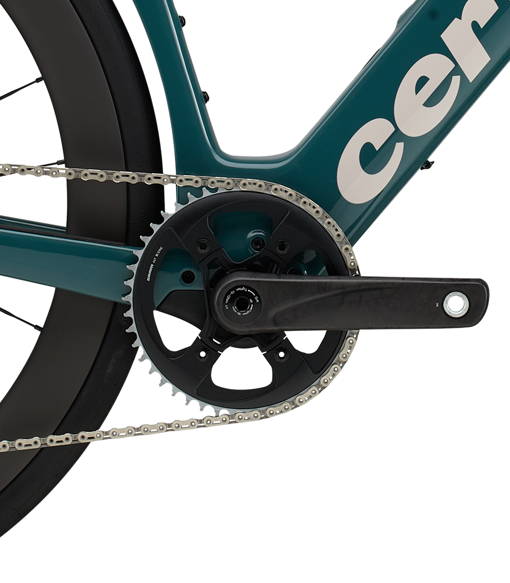

Rouvida gets you to fast, well, faster. Sleekly designed around the Fazua Ride60 motor, Rouvida delivers 60nM of torque paired to a 430wH battery, and assists you all the way up to 28mph—pro peloton speeds on the road, and edge-of-control-two-wheel-drifts off-road. That’s right, Rouvida comes in two configurations: road and gravel. We designed some clever interchangeable dropouts that significantly alter the geometry of the bike, so the road bike feels like a road bike, and the gravel bike feels like a gravel bike. No compromises, just speed.
