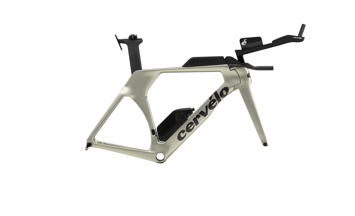

| Reach | 389 | 406 | 420 | 433 | 446 | 455 |
| Stack | 461 | 482 | 498 | 516 | 535 | 556 |
| Bb drop | 75 | 75 | 75 | 75 | 75 | 74 |
| Seat tube angle saddle height | 580 | 630 | 680 | 720 | 740 | 780 |
| Head tube angle | 71° | 72.5° | 72.5° | 72.5° | 72.5° | 72.4° |
| Fork axle to crown | 367 | 368 | 368 | 368 | 368 | 369 |
| Fork offset | 52 | 43 | 43 | 43 | 43 | 40.4 |
| Trail | 62.1 | 62.1 | 62.1 | 62.1 | 62.1 | 65.3 |
| Front center | 582 | 583 | 602 | 622 | 640 | 654 |
| Head tube length | 59 | 71 | 88 | 107 | 127 | 148 |
| Wheelbase | 975 | 976 | 995 | 1015 | 1033 | 1048 |
| Standover height | 739 | 759 | 775 | 792 | 812 | 906 |
| Seat tube length | 475 | 496 | 513 | 530 | 550 | 571 |
| Top tube length | 513 | 535 | 553 | 571 | 589 | 604 |
