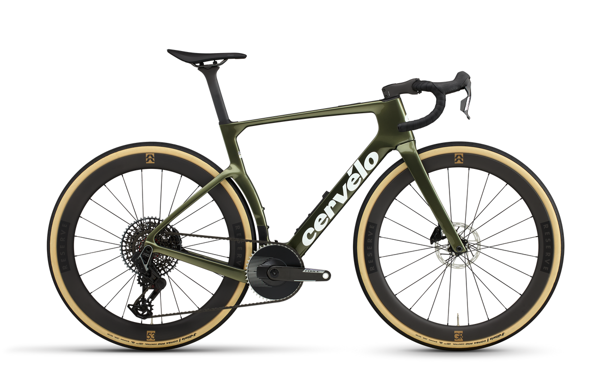

The all-new Áspero-5 was built for the front end of the race, and is the most aerodynamic gravel bike ever created. Cervélo has long been synonymous with aerodynamic performance, and we’ve brought that 30 years of expertise to gravel racing. With clearance for 45mm tires, downtube storage, and a threaded bottom bracket, Áspero-5 is ready to race the second it rolls off the shop floor. It made its rainbow-jersey debut (and won!) under UCI Gravel World Champion Marianne Vos, and is campaigned by some of the most elite bike racers in the world.
